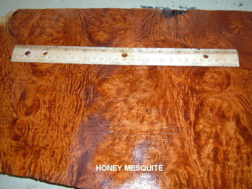

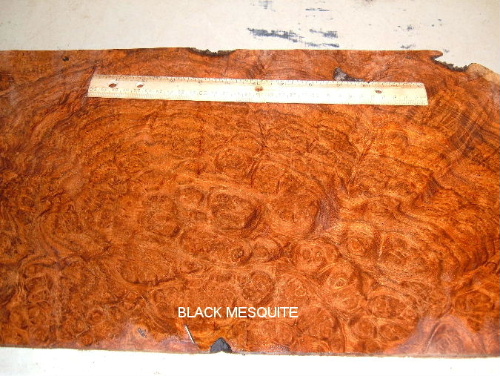

Before this thread falls back to far, I'll post some true mesquite burl photos. I've never seen "birdseye" mesquite. That would be "true" birdseye figure of the indented ring figure class. Often folks mis-lable burl buds as "birdseye" which is confusing. This happens on eBay a lot with maple "birdseye" burl...NOT!!...there's no such thing!! I have two mesquite species that I cut solid body tops from, but do not cut acoustic burl sets because I think it's much to risky for that use. The black mesquite burl comes from South America and the honey mesquite from Mexico. Honey mesquite rarely produces burls larger than a 2 pound wart on the side of a tree.

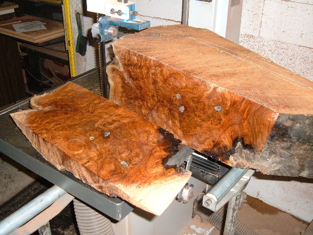

I have a customer coming to the shop today for some solid body bass tops of mesquie burl. Fred Bolton of Bee Bass. Thought you might like confirmation that large mesquite burl does indeed be real. I chainsawed this chunk off a 700 pound whole burl. It's 9" thick and 30" at the longest point. It is black mesquite.
